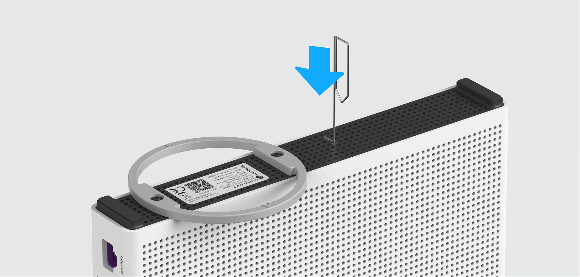

If your Internet-Box is experiencing issues and a restart doesn't solve them, the device can be reset to factory settings. Here's how to perform a reset on your Internet-Box:
  1. Plug in the Internet-Box and turn it on. Then, wait 2 minutes for the Internet-Box to start up.
  2. Perform the reset using the method shown in the image below by pressing the reset button on the underside of the device with a pointed object for 1 second.
  3. After a successful reset, the status LED will start to blink white, and the Internet-Box will restart.
After the Internet-Box has restarted, the LED will shine steadily white
again. The reset is successfully completed.
