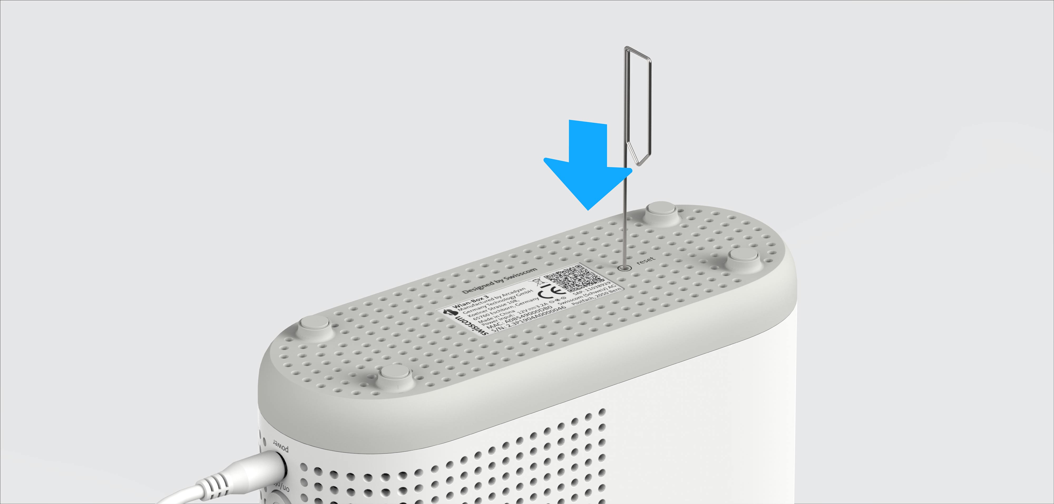

If your WLAN-Box is experiencing issues and a restart doesn't solve them, the device can be reset to factory settings. Here's how to perform a reset on your WLAN-Box:
  1. Plug in the WLAN-Box and turn it on. Then, wait 2 minutes for the WLAN-Box to start up.
  2. Perform the reset using the method shown in the image below by pressing the reset button on the underside of the device with a pointed object for 1 second.
  3. After a successful reset, the status LED will start to blink white, and the WLAN-Box will restart.
After the reset, the device can be reinstalled using the My Swisscom App.
